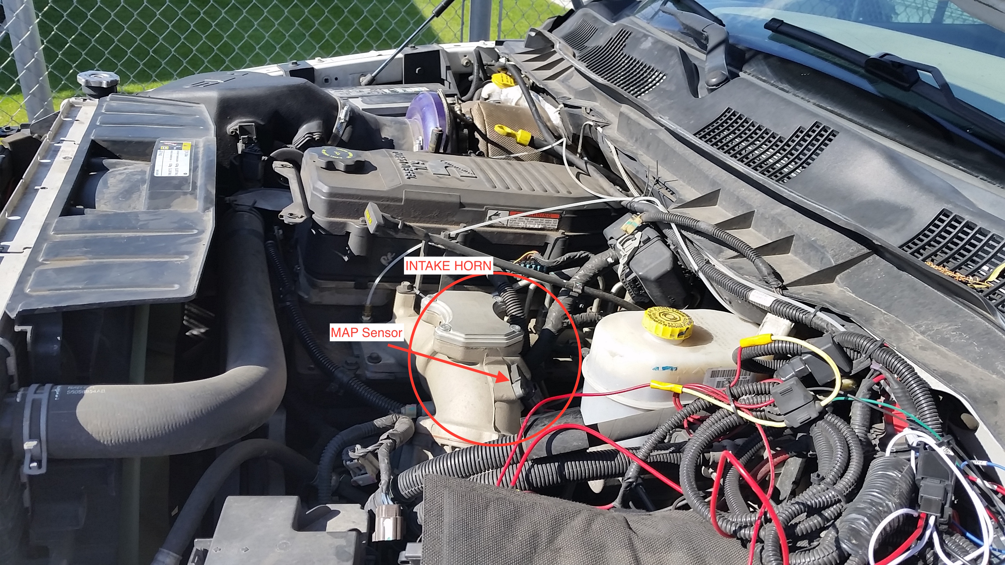

What about with a Cummins 6.7 Diesel? We have been chasing this code for 3 weeks.
Noticed this is a popular rig for modifications – have you done any? If that’s the case, temporarily removing mods for testing might reveal problems with the mods or the connections to them. Corrosion in butt connectors is my personal favorite (always crimp-solder-shrink with marine shrink tubing and fill connectors with dielectric grease). On the other hand, the most-common issue I’ve read about is soot blocking the MAP sensor (How to Clean the MAP Sensor) or the MAP sensor port.
A sticking EGR valve can also cause this problem. This RM Page Might Help?
