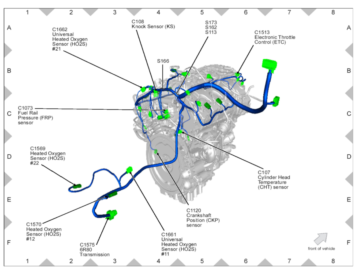

SPECIAL NOTES: Non-professional mechanics should take note that in order to diagnose code P2198 (or any other oxygen sensor related code), it always helps to gain at least a working knowledge of what oxygen sensors do, how they do it, what the major difference between the various types of oxygen sensor are, and how oxygen sensors differ from air/fuel ratio sensors.
While a detailed discussion of these issues falls outside the scope of this guide, it is worth mentioning that some oxygen sensors generate a signal voltage on their own, while others rely on a 5-volt input voltage delivered by the PCM (Powertrain Control Module) in order to work. However, regardless of the type of oxygen sensor used in any particular application, all oxygen -, and air/fuel ratio sensors have the function of monitoring the concentration of oxygen in the exhaust stream in order for the PCM to control the air/fuel mixture, but it is important to know how these sensors do what they do.
In short, oxygen sensors that generate their own signal voltages work by changing the signal voltage in response to the constantly changing levels of oxygen in the exhaust gas, while sensors that rely on an input voltage work by changing their resistance in response to changes in the oxygen content of the exhaust gas. This is an important distinction when it comes to diagnosing this code, which makes it imperative to read the section on oxygen sensor-related problems and diagnostics in the application’s repair manual before attempting a diagnosis of this code.
Moreover, the two main types of oxygen sensor are also electrically opposite, meaning that a reading that indicates a rich-running condition on one type of sensor will indicate a lean-running condition on the other type. While the two types of oxygen sensor can be distinguished by the number of wires they have in their connectors, bear in mind that apart from being different from each other, both types of oxygen sensor are also fundamentally different from the air/fuel ratio sensors used on many Japanese applications. Therefore, it must be noted that the two types of oxygen sensor are NOT interchangeable, and NEITHER type of oxygen sensor is interchangeable with air/fuel ratio sensors.
In light of the above, it should be obvious that this guide cannot provide detailed diagnostic and repair information that will apply to all applications all of the time. Therefore, the information provided here is intended for general informational purposes only, and proper reference to the application’s repair manual MUST be made before any of the information provided here is used in ANY diagnostic and/or repair procedure.
Nonetheless, diagnosing code P2198 is not an overly complicated affair, and although an oscilloscope is the recommended tool with which to diagnose this code, most non-professional mechanics should be able to diagnose and repair this code on almost any application using the information provided here, even if an oscilloscope is not available. END OF SPECIAL NOTES.
OBD II code P2198 is a generic code that is defined by all carmakers as “O2 Sensor Signal Biased/Stuck Rich Bank 2 Sensor 1”, with “Bank 2” referring to the bank of cylinders that does not contain cylinder #1, and “Sensor 1” referring to the oxygen-, or air/fuel sensor (typically used on Japanese applications) located upstream of the catalytic converter. This code refers specifically to the fact that the oxygen or air/fuel sensor indicates a continuous rich-running condition, which is rarely caused by anything else than a failure of the sensor itself, but take note that in the vast majority of instances of this code, the code is merely the result of a sensor failure. Although not altogether impossible, actual rich-running conditions are relatively rare when this code is present, for reasons that will be explained below. Note also that the length of time during which the rich-running condition is indicated varies between applications, but be aware that if the condition is indicated by a flashing warning light, the condition is serious, and fatal catalytic converter damage may occur.
